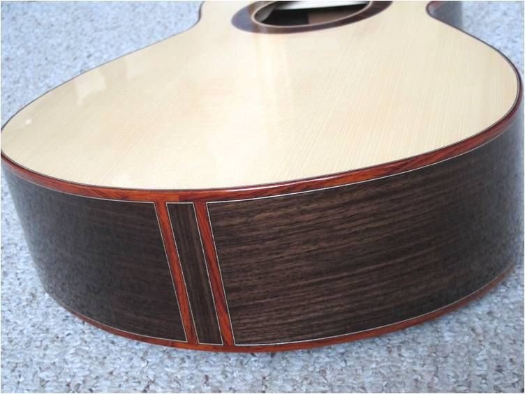

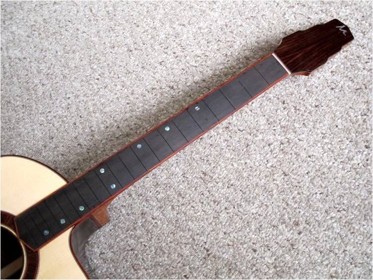

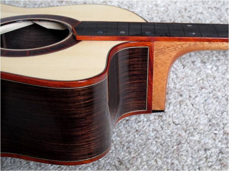

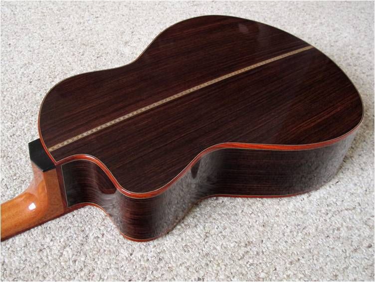

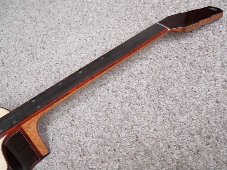

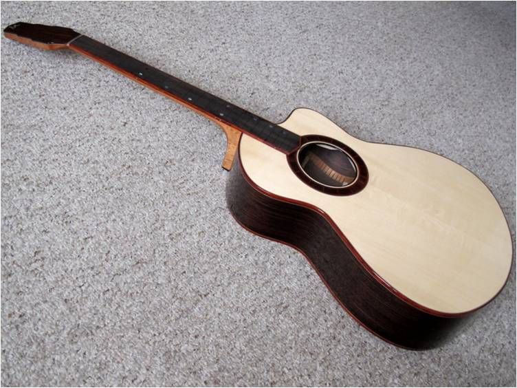

I wouldn't say it's stunning compared with a lot of the guitars I've seen on this forum, but hopefully you like the rest of it. Here are some non-glamour type shots taken on the carpet.
These users thanked the author J De Rocher for the post: Pmaj7 (Sat Oct 03, 2015 7:15 pm)
